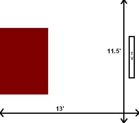

So Im just getting into home audio, Ive been reading a bunch of threads over here and all that, but I was looking for some help specific to my situation.
So here is a mspaint drawing of my bedroom lol, the tv is a Samsung LN37B650
red box is the general area of where I watch the tv from.
- Is a 5.1 system ok for this size room? or is it rather small room for a 5.1?
- Is where I watch tv from a problem? I hear that having a system where youre viewing position is against the wall presents some problems.
Right now Im looking to get a home theater in a box, thinking of getting a SONY HT-SS360 (looking at the ONKYO HT-S3200 aswell) I dont mind spending some more $ though. I know buying everything separately is the way to go but Im not ready to do that yet.
I love the tv and watch bluray movies all the time, and want a decent home theater system to make the experience even better. Ill keep researching, and Id appreciate any advice / comments. Thanks
Yes, it is kind of small, but if that’s all you have to work with, then that’s the way it is. Truth is, every system/room involves compromises of some kind.
The main issue is that you can’t get the rear speakers behind you, and that sitting close to a boundary the bass frequencies are reinforced. The latter can be dealt with by turning down the subwoofer a bit.
Also, in a room that small, a big problem is that the rear speakers are located so close to you that they are easily localized, and that’s a distraction. Mount them on the 13 ft. wall firing towards your seating position. Experiment with different heights, to minimize the localization. Another option might be to place the face-up on shelves on the wall, so the sound could bounce off the ceiling
Look up on-line reviews, get the best system you can afford. Consumer Reports recently gave the Onkyo S5200 a top rating, if that helps; the S3200 appears to have the same speakers, but a different sub.

His LP is basically centered between the side walls. Therefore, he could get good effect with 5.1 by placing the side surrounds on the side walls. I would discourage 7.1 due to his against-the-back-wall LP, but 5.1 should work fine:
