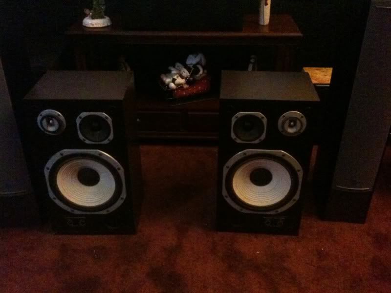

ok so i was at a buddy's house and he had some old vintage gear in his basement which looked to be in great mint shape but he was not using it. I decided to take a change and bought it all from him..but i'm having a hard time finding out any values for this gear.
I really just want to feel better about what I paid...so any help??? here's the list
Kenwood KA-9100 Integrated Amplifier
Kenwood KX-830 Tape Deck
Kenwood KT-7500 Tuner
Kenwood KD-5077 Turn Table
Kenwood matching stand the gear fits in made for it
Kenwood Speakers LS-990 in great shape (Very heavy!!!)
He said he paid a lot of money for this back in the day and i'm sure he did...but I wanted to know what it was worth now? and is it worth more since it's all together and matching with matching cabinet and matching speakers? or would I be better off breaking it up and piecing it out if I wanted to sell it? ANY advice would be appreciated!!! (These pictures are borrowed from an online search...it's just easier)

i doubt it will matter much if you keep the speakers with the same amp, both for resell value and system performance. if they are in great playing shape and youre trying to set up a vintage system i would say keep them, and after a few weeks/months of listening you should have a good idea as to whether you like them or want to replace them. same to the electronics
what did you pay for the set? i know thats a bit of a personal question, but that is the best way to determine if youve got a vintage goldmine on your hands. if the gear is in great or near-mint condition, i guess as long as you paid less than the original msrp youre coming out ahead
the general advice ive heard from yesteryear electronic hunters is to always no the difference between "vintage" and "old". hopefully you landed on the right side of that one!

Dude, are those pictures of your actual gear? If so they look mint! Well I like vintage gear, most of the stuff I find is a little shop worn. Check out ebay and look for your gear under "completed items" to get an idea.
I'd hold onto the stuff and enjoy it if it were me. How do you like the sound?
