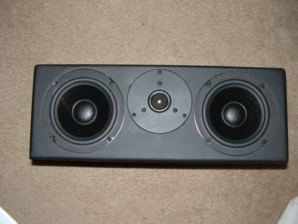

I built the tri-trix's for a friend, and even built him the matching center
you just need to modify the cabinet a little bit.
Modify I can do. I made an assumption that the TL enclosures would be bigger than a sealed enclosure, I don't know if this is really true. It was this assumption that had me thinking about making the center sealed to keep it as small as possible. I wasn't sure how differently the different enclosure types would respond, maybe I should just plan on building three of them with the same enclosure.
2
I wish I could remember what size I built the center.... I know it was off a bit from the "sealed" version of the tritrix
I remember that the front was cut at 7 1/2 degrees so it was ear level from 10 feet back.
