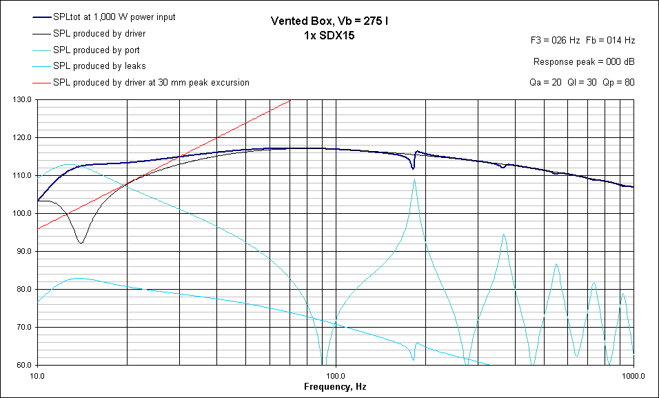

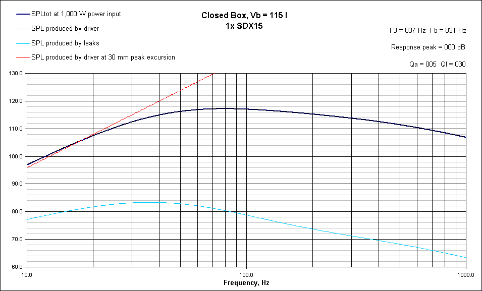

Sometime next week we expect the first shipment of our next
subwoofer in the Subduction series, the SDX15. Introductory pricing
is US $270, C $300 shipping included.
This is the first high excursion Subduction driver using a 3" XBL^2 (TM) motor with dual 2 ohm voice coils.
- fiberglass/nomex woven cone with NBR surround
- high power, low inductance design, 2 layer 3" copper voice coil and large aluminium shorting ring inside the magnet
- forged and machined T-yoke and top plate with larger radiused pole vent for low aerodynamic noise
- high excursion spider with integrated lead wire
- attractive cast aluminum basket design with cast aluminum trim ring
- long Xmax (30mm) and a "bottomless" basket design
I think it works really well in both 'LLT' and medium sized sealed alignments. Please note that these sims are based on the preliminary T/S parameters, which are subject to change.

14 Hz and 275L will result in 6"/35.5" long port. That's pretty hard to fit in. I'd make it 300L and 15 Hz (~27.5" long).
Well if one was using 24" tube, certainly. It'd easily fit in 22 (granted its hard to find) or 20in tube.
And 300liters/15Hz doesn't really give such a nice EBS type FR, at least not in simulation. It'd be ideal in a really large room that didn't have much room gain, but otherwise?....
It seems that Unibox gives a little bit flatter response than WinISD.
But anyways, some rise in in-room response below 20 Hz doesn't hurt that much. 300L and 14 Hz would be my choice.

Nevermind. I don't know what was going on, my 300liter/14Hz graph pretty much matches yours now, and yeah, it looks good.
Dunno what was going on...
I have approximated Le2=3 mH, Re2=3 ohm. I have also permanently changed the Rs value to 0.1 ohm (I think that's more closer to reality).
