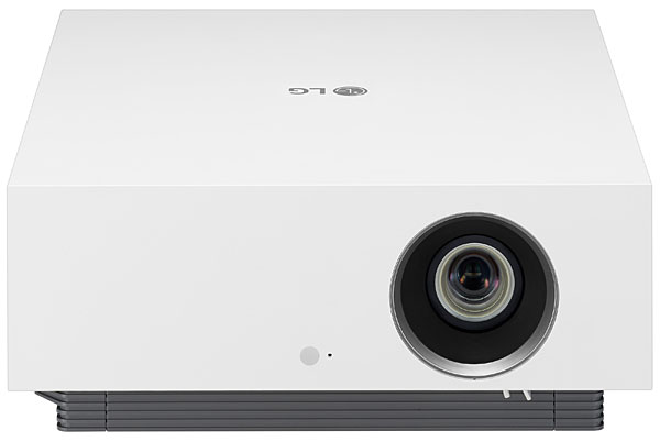

Official owners thread for the LG CineBeam HU810PW/AU810PB, MSRP's of $2,999 and $3,999.
Note: Having owned this PJ for almost a year I would have to say think long and hard before purchasing.
LG simply doesn't support this product and has not released a firmware update of any kind since launch. Customer support for issues is terrible.
HDR and Tone Mapping are not working properly with HDR being way too dark making many scenes unwatchable. LG doesn't care. The PJ also can't properly do 24p causing judder which you may or may not be susceptible to. Likely also an easy fix via firmware.
Out of the box this beamer is so blue it is ridiculous, in any mode, and not fixable without calibration of white points. Believe the native white point is closer to D93k than D65k.
SDR can be really, really good in this PJ once calibrated but it is not for the faint of heart. But once calibrated SDR looks phenomenal.
HDR can be made to be pretty decent using Calman Autocal, though for this PJ Portrait barely supports it and good luck getting answers to questions on it. Plus to get it decent you effectively have to stop using DTM which was a huge selling point of this PJ and works really well to not clip/crush highlights, but crushed shadow detail severely as a result. Pretty easy to fix by LG by incorporating a slider that adjusts the low end of the EOTF curve, but again LG has no interest in supporting this PJ.
Now, if you have a MadVR setup, a meter, and Calman for Home LG, this PJ can shine. Or, if you don't care about reference and just that your picture "pops" or don't really care about HDR, this PJ may also be fine for you.

Pro's of this unit:
  • Rated for 2,700 ANSI lumens, gets plenty bright!
  • Adjustable/mechanical Iris, so can also get fairly black with pretty good contrast
  • DTM/HDR, Frame-by-frame dynamic tone-mapping
  • Laser lamp life of 20,000 hours
  • Dual-laser configuration with red and blue lasers plus a phosphor wheel
  • DCI P3 up to 97%
  • Does not need/use a color filter
  • HDMI 2.1 for eARC (limited to 24 Gbps, supports uncompressed 4K/60 up to 12-bit color depth)
  • Supports Filmmaker Mode (recognize the flag in compatible content that tells the projector to turn off frame interpolation and other default processing)
  • Full off to on in about 12-13 seconds
Cons/Known weaknesses/issues with unit:
Pre-Calibration Greyscale tracks horribly:
If you look at the S&V test bench results, you'll notice just how blue of a tint this PJ seems to come with from the factory. Mine (and others) is even worse. Setting the Iris below 5 while it improves "blacks", causes blue to shoot through the roof even more.
Further, calibrating it out isn't that simple as 2-pt does a good job at IRIS around 7 to 10, but struggles as the Iris dips below that. Believe you need Autocal (and hope it actually works in your case ... mine and others is no longer working) to rewrite the LUT.
Manual Focus and Lens shift levers:
- Unit comes with manual focus and manual lens shift levers, so no lens memory, and it can be a pain to focus the unit properly on your own without some sort of inexpensive spotting scope device such as this (props to @DunMunro)
