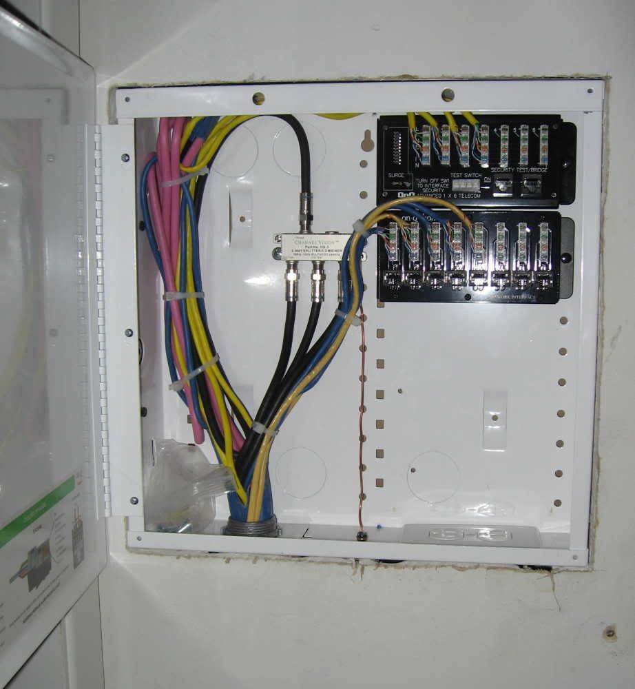

My contractor recently installed a panel for cat5 and coax connections in my office closet and I noticed there is an outlet within the panel itself. There is also an outlet a couple of feet below the panel which I requested. He stated that there is room to put a DSL modem in the panel itself, but I am unaware of a small UPS which can fit in there. What do people normally do in this situation? I plan on having the router and switch sitting on a bench right below connected to the outlet outside the panel. Of course I'll have to leave the panel open, but if I could fit something in that panel it would be nice. Thanks for any info.
I also noticed none of the cables are labeled, should the contractor label the cables normally? Thanks.

In my opinion, a pro would always label everything. That being said, I can't count how many times I've walked in to a job where a contractor has not labeled anything.
I would definitely ask for them to be labeled - it will save you tons of grief and aggravation down the road.

1) He should label, although you should be able to figure it out relatively quickly if he refuses.
2) As for a UPS, why would you bother for a DSL router? If your power goes out, you're not going to be computing for long anyway and you don't need the dsl router to shut down or save information. Arguably your switch and internal network router could go on a UPS especially if you use your network for file sharing, but even that seems like only someone in a mission critical kind of environment would really need it.
FWIW, for surge suppression I love my APC P1T . That should fit in that outlet and help suppress surges.

Well, I'd like to still continue using the internet for short downtimes. I also imagine I might have to physically recycle the modem if it did go down, so a UPS seems like an important component for the DSL modem, in addition to the switch and router.
I guess I must be in the minority here but I'm going to use a UPS for it even though that means that outlet in the panel becomes absolutely useless. Thanks for your feedback.

Thanks for the suggestions everyone. Since I still need the router which won't fit anyway, and there is already an outlet a couple of feet below the panel, I'm just going to use a larger UPS and store everything on a shelf below, leaving the door open. Won't be a pretty site, but since it's a closet it doesn't really matter. Thanks.

-If you must have 1 and want to mount it below the box on a shelf or something, you may want to try and make another knock out in the bottom of the box or something and run your cable from the ups through a split plate in the wall and up into your panel through the knock out you made. Just a suggestion. Atleast then you could close the door.
Keep in mind, running standard power cords behind dry wall is against code.
True but it's not like he is an installer doing the work for someone else and has to worry about an inspection.
And if both the plug and the equipment are exposed, it's pretty unlikely to be a hazard. Part of the code concern is having the plug/receptacle be inaccessible.
