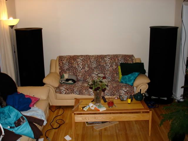

I'd go with ported. I have 2 RL-p15s in 260 L sonotube enclosures tuned to 14 Hz that I am flat out amazed with. You can build a ported enclosure as a sonotube or as just a box, it really just depends on what you want and what you think looks good.
Here are mine:
