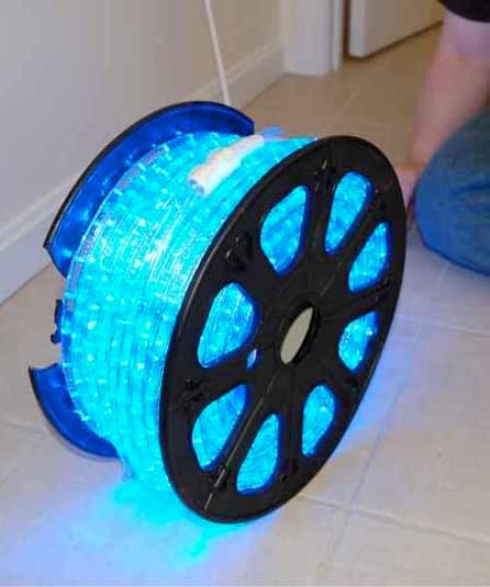

Pretty!!!!!!!!

Dave,
Was that the rope lighting from 1000 bulbs? What color as it looks a little blue in the picture?

Should be. Its is blue LED's, and yes its from 1000 bulbs.

Dave,
Is the blue LED light you bought dimmable? I really looks sweet and I am in the market for some.

Gonzo -
Everyone seems to say so, at least in a few threads. Cherokee did it with zwave dimmers (using clear LED rope from them), and some one else (can't remember) confirmed that it works with a grafik eye. I will be able to confirm it works with a GE on Wed/Thurs - depending which day the electrician comes out.
Its ghastly expensive at about $3.70 per foot shipped for the spool. I'll use about 1/3 of the spool, and had a couple inquiries on the rest since I am going to sell the remaining stuff at a discount. There was an e-bay seller who had one with similar specs for about half price, but I had no way of knowing if it would be dimmable, and no real return policy. I held my nose and hoped for the best.
If anyone loses interest, I can let you know if I have some extra. I want to see how much I have left, and how much people need (first come, first serve for Oman and then Bud). Cherokee said they'd sell custom lengths but I didn't notice that on their website and didn't call. Would have been the cheaper option than taking the whole nut, and selling my excess.
I am really looking forward to it going up, to see if I wasted my money.

Dave,
I could not use the LED due to the low wattage as the Vizia Z-wave dimmers needed a minimum of 40 watts to work correctly. I actually had to take back the Costco LED lights because of that problem. I did purchase the regular 3 watt/foot rope lighting from 1000bulbs.com and it works great. They do custom cut lengths of the regular rope lighting but not sure on the LED. I only needed to purchase 42' so it was pretty cheap.
