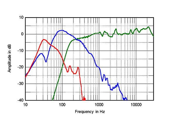

This is a graph of the response. Note the peak at the 7K point. It's right in the sibilance range and could be the cause.
https://www.stereophile.com/images/419EmoT2fig3.jpg
See less See more
