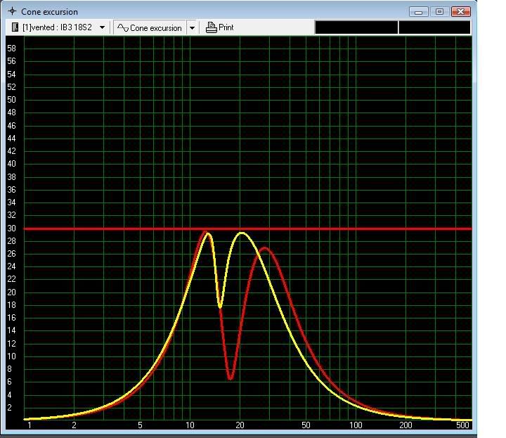

I've been eyeballing EP2500's for a while because they seem very well priced around $300. Playing around with the sub I've already got, if I were to do dual IB3 18's in dual 125 cu ft boxes, I'd only need 700 watts per sub... 2 quiet sleek 1000 watt plate amps mounted in the boxes would be sweet... but not for $425.00/ea off PE! Why are plate amps so much more expensive?
Just for fun... IB3 18 125 cu ft 16" port 15Hz tune 700 watts HP 14Hz: yellow
My current box 22 cubic feet 7.5" port 18Hz tune 1100 watts HP 17Hz: red
