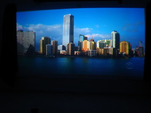

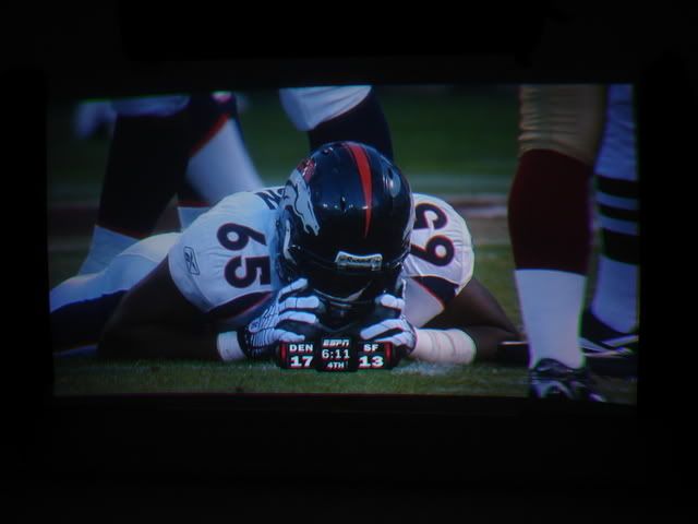

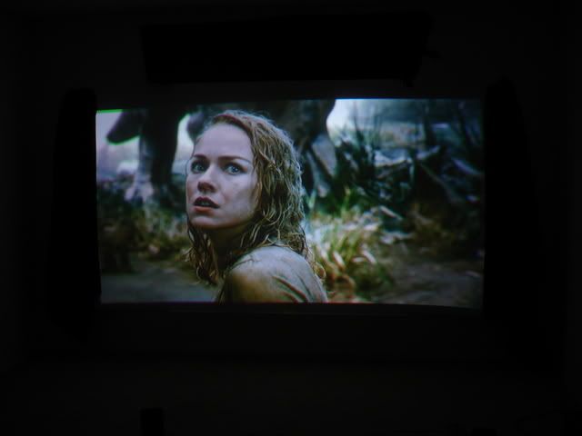

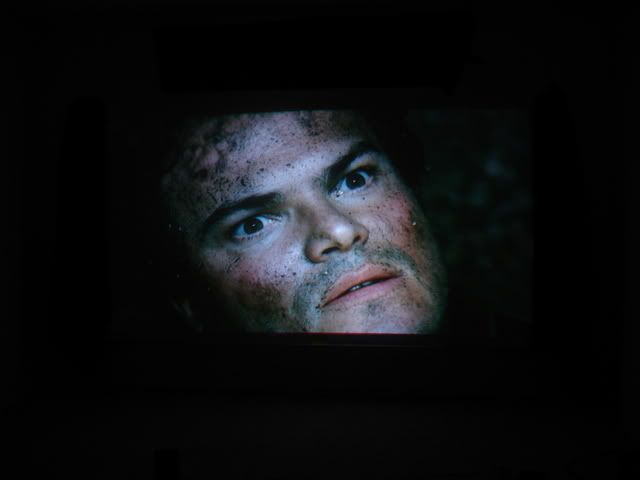

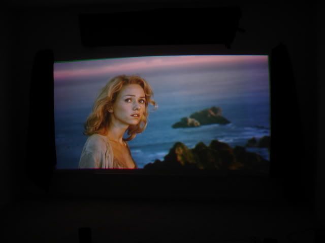

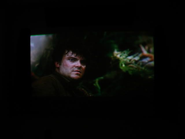

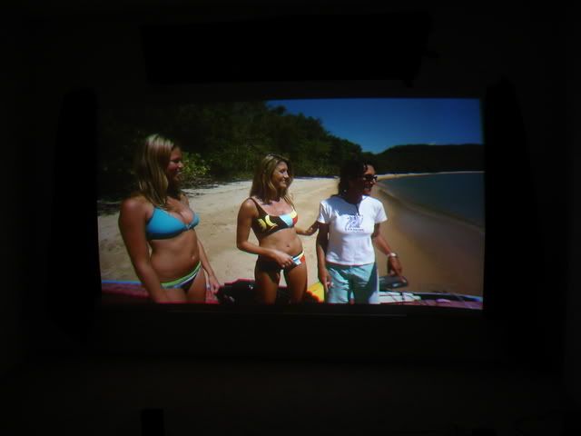

Just getting around to trying this thing out. I'm using a Wilsonart Designer White screen to test with. Here are a few shots with a rough setup. Picture settings were 35 for contrast and 60 for brightness when I turned it on and have not changed those settings.

Is the screen small? 35 contrast is very low.

The screen is 100" wide by 56" high. I tried bumping up the contrast and while it looked better in some cases, I kind of preferred the overall look the way it is. Shadow detail was better and looked more film-like. Once I get the projector mounted and converged correctly I may play around with the picture settings more. I might also need to try a different transcoder as I think the one I have is crushing blacks a bit.

Wow,
That looks good; I really need to pick up some of that DW and some HD-144's for my Quee

Thanks! I'm not the best at taking screenshots by any means and I have a long way to go in setting up this projector. However, I could see an instant improvement with this Wilsonart fomica screen over the plain blackout cloth screen I was using before.
