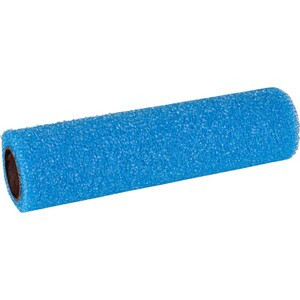

Main product image for foamPRO 9 Foam Roller for Textured Finish260-2150
foamPRO 9" Foam Roller for Textured Finish
Part #260-2150
Per item price :
$6.98
$6.98
Save for Later Delete

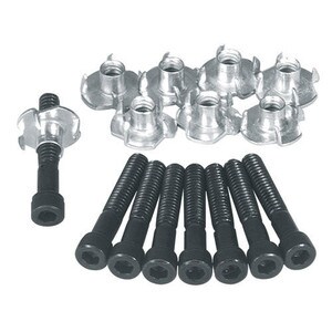

Main product image for Cast Frame 1/4-20 Speaker Mounting Kit 260-778
Parts Express Cast Frame 1/4"-20 Speaker Mounting Kit
Part #260-778
Per item price :
$5.49
$16.47

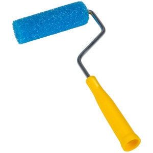

Main product image for foamPRO 4 Textured Roller with Handle260-115
foamPRO 4" Textured Roller with Handle
Part #260-115
Per item price :
$7.39

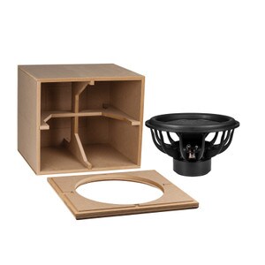

Main product image for Dayton Audio 18 Ultimax Subwoofer and Cabine 300-7099
Dayton Audio 18" Ultimax Subwoofer and Cabinet Bundle
Part #300-7099
Per item price :
$523.88
$1,047.76

For music I think I would save the $ and just build a couple VBSS' using PA460s. You'll only need 700-800 watts so 3000D would probably suffice.
I’m not interested in cutting any of the wood at this time.
its well within what i was thinking of spending. I just still wonder if I would be better off with the pa460s or even a smaller sized speaker more full range - although i do plan to use them with a 8k tv i just picked up as well
If music is the priority PA460s for sure but I'm not sure what box I'd put them in. If you want more balance between midbass and low end I'd go for the LaVoce SAF184.03s in a Mini-Marty or something. The price is still $285 on those but I'd expect the price on those to jump up soon like everything else. The UM's are geared towards low end.
