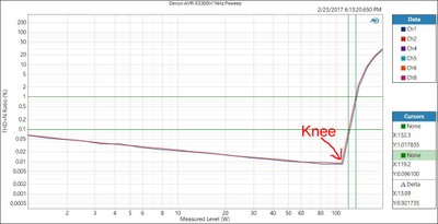

The graph https://www.audioholics.com/audio-a...wer-ratings/AVRX3300Wpower.jpg/image_preview2 does indicate the THD decrease while the power (W) increase BEFORE the knee point; and then increase after the knee point. This is power sweep at a constant 1khz though, not sure if that pattern holds for the above 20 Hz - 20 kHz case.
