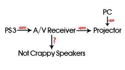

So I just purchased an Epson 705HD projector and I'm not really sure how to go about bypassing its crappy internal speakers when playing video games. Is this the solution? -
Will any ol' receiver with these connections output the audio simultaneously through 2 different ports without any trouble?

So to answer your question - any receiver that passes HDMI video out will also pass sound to speakers. Then as scoob states turn of sound on the projector.
Now some receivers will not pass video so those you would wire
PS3 - directly to Projector
PS3 with audio cables to receiver (enable video out through HDMI and audio through analog in the PS3 setup men)
Then receiver to speakers

It's actually still in the mail on its way here, so I'm just doing a little planning... I would imagine turning the sound off will be pretty simple. Thanks very much for the PS3 audio output settings advice though, that was what I was looking for. Now time for a good "starter" receiver, that projector almost cleaned me out. Any suggestions?
