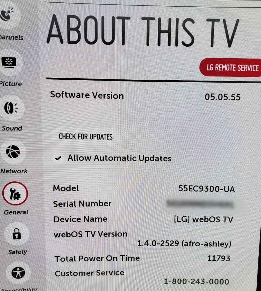

#58 ·
Welcome aboard (and what a fantastic first post!).
Can you tell us a bit more about your EC9300:
-How long have you had it (when was it purchased)?
-What setting for OLED Light do you use?
-What are your pimary viewing habits (streaming/bluray, cable/OTA broadcast, gaming, etc...)?
The fact that you've got close to 11,000 hours with your EC9300 and are still happy with it is great news for those of us with newer WOLED TVs - thanks again for your contribution and feel free to ask for advice when you get ready for a bigger OLED TV (I've moved from a 55EC9300 to a 65C6P and will be moving to a 75/77" WOLED TV in 2019 or 2020...).
