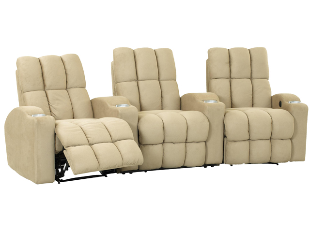

Alternatively, I am thinking about classic movie theater chairs at the back, like this (four chairs) :-
Since they're small and don't recline, this will allow me to put a riser of only 4' (seats themselves only need 28". They obviously don't have a foot rest. If I add 20" of aisle space in the front then I can get away with a riser of 4' depth.
Alternatively, I can use these non-reclining (they recline only slightly) at the back :-
This will also allow 4' distance between back seats and front seats. 4' is very tight, but my main regular seats will be at the front. For back I am just trying to find a good option that I can use if more people (more than just my kids and I) are watching. My brothers often visit and we watch movies together.
Also, if I put my main sitting area at the front then the front row will be ~12' 5" from the screen. Is that too close for a 106" screen? The screen has 0.8 gain and the projector is 1080p with 1800 lumens (if that makes a difference).
Another option is to just use normal (but with tall back and high seat) at the back without riser and seats with short back and short seat back at the front so I don't have to use a riser. But then I am worried that the front row may be too close to the screen. I do have the option to move the home theater wall in by 7" (I built the frame 7" further from where I had to so I could put the center channel behind the screen, right at the ear level ( otherwise I'd have to either put it above the screen or below it).
Yet another option is to use a couch at the back on riser and home theater seat at the front.
