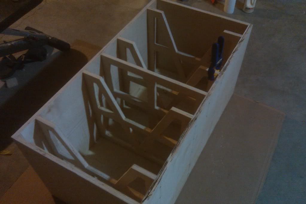

I hope you used Titebond II.. to mate the surfaces of the box... PL is for the bracing....

Yep, and I also used a bead of pl400 on the inside to ensure it's air tight.

I'd use PL over titebond, that stuff is invincible, and it expands.
PL is fine for sealing... but it will fail as a strictly wood glue... you don't see carpenters using that stuff...

What are your plans for finish? What can you do protect the driver cones if you have kids? I guess you can make a beefy grill how do you keep a homemade grill from rattling?
Looking good so far though

That looks great.... it will look better if you weren't using a cheap a$$ camera..

Not correct. PL Premium especially is some of the best glue for wood that is available. It is also very good for for MDF and end grain because it is not water based so it will not wick.
The downsides are that it is pricey and hard to clean up. I have used it without gloves and had it on my had for several days.

Get some good heavy duty magnets and sink them for a magnetic grill before you do the finish work - if your doing grills that is.... Not a big fan of grills myself, and little ones don't really like to mess with the big monsterous vibrating cones all that much...

I'll fill the screw holes with wood putty, sand it down, cover it with an outdoor waterproof primer, then just a flat black latex paint. Nothing fancy.
