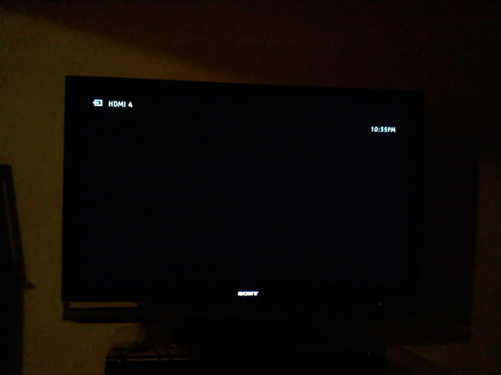

kokidkane. The first picture you posted was of a blank screen. If you took the picture a few seconds after switching to HDMI 4, the TV may have gone into auto-dim mode and turned down the backlight to hide the clouding. The easy test is to start a movie when the credits are almost over and fading out and then pausing it through your DVD/BD remote. Try getting a mostly dark scene with just a word or two. Would love to see a picture of that.

Originally Posted by kokidkane /forum/post/15550215
Here is the pic you wanted to see hope it is what you where looking for btw the blacks look great on this tv
sorry if my phone pics are not high def
you forgot to set the exposure to super long so the whites glow extremely hot. only then can you enter the insanity that is cloud peeping. the lettering should bloom till it looks big and fat.
Of course the fact that it's a picture taken by a sensor that isn't as sensitive as your eyes and displayed on a different display from the one you're worried about might make a difference.
