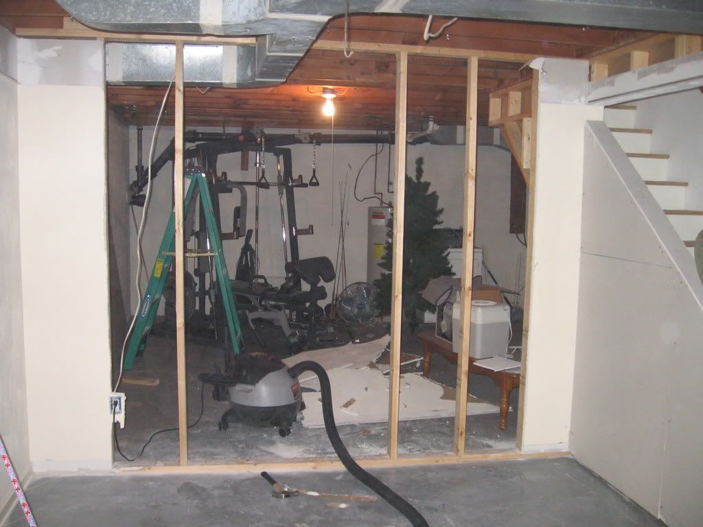

Screen wall looking out to seating area ( the pieces of wall you can see will be removed)
Seating area looking towards screen wall (the new wall is going where the shop vac is)

Tried to do a little design with Google Sketchup and this is what I have so far. What do you guys think about the layout? This is my first experience with home theater so all the help you can give is appreciated. Thanks!
