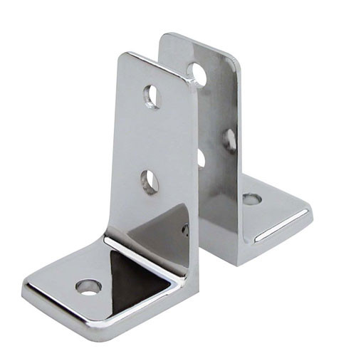

Thinking a little further you might be able to find pre-made steel L brackets that could work simply by drilling the appropriate holes in them. Imagine from the image below of two small back-to-back L brackets how you could use two pairs of much larger L brackets with one pair bolted back to back on each side of the TV VESA mount with the bottoms of the Ls going in different directions to serve as stabilizing feet. If you could find the right size there'd be no metalwork involved other than drilling the appropriate size holes for the VESA mount.
