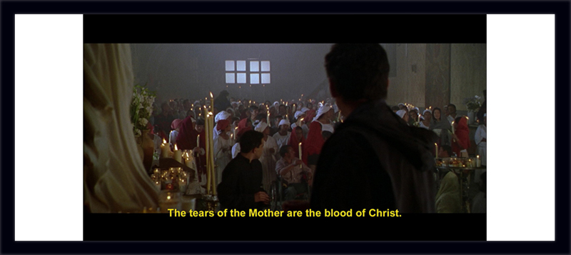

I purchased the Region A release of "Stigmata" on Blu-ray. The forced subtitles fall outside the visible frame and are burned in. See below.
Prior to performing the vertical stretch and deploying my a-lens...
After performing the vertical stretch and deploying my a-lens...
My solution, I imported the Blu-ray release from Germany. I figured there was a good chance the forced subtitles wouldn't be burned in and they weren't. As such, I was able to reposition them though in my case I re-authored the Blu-ray repositioning the subtitles using BDSup2Sub. Much better wouldn't you say.
