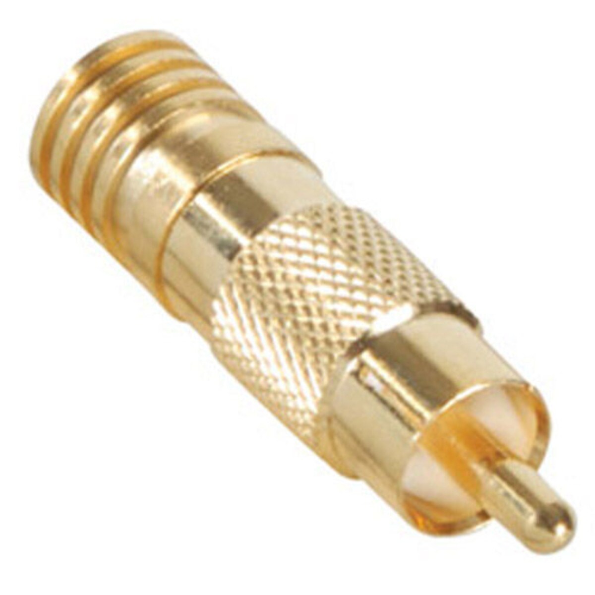

· Registered
Joined
951 Posts
· Registered
Joined
448 Posts
So all you do is add this and coaxial became sub cable??
Yup, that’ll work fine and it’s simpler than what I did. I used crimp on RCA’s from Radio Shack similar to below because all I had was RG6 with bare ends. Back then Radio Shack stores still existed and Amazon didn’t... :sneaky:
  • Like
Reactions: t0406peru
