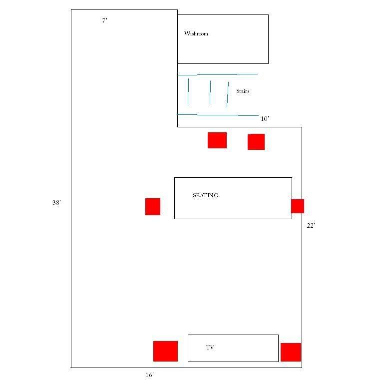

Been lurking but I finally decided to jump the gun and make a thread.
Here is a picture of my basement set up or what I hope to achieve.
My ceiling height is 8 feet high and I have a hardwood floor.
I don't have much experience and this is my first home theatre build so I'd like to know which woofer would work best for this room. I play lots of games but I think the sound will actually be put towards movies.
I'd like to know if the pb-12 is worth the price increase from the sb-12 and if the pb13-ultra should be considered and if that's worth the price increase from the pb-12.
Also if you notice that I haven't drawn the sub in....That's because I also don't know what the optimal placement of it should be.

Placement of a subwoofer is very tricky, you really have to move it around the room and see where the sweetest spot is.
If you are considering the PB13-Ultra and have the money for it, I would suggest you go for that. Seems like the area you're gonna be putting it into is a pretty big space to fill with SPL.

I thought the sb12+ might be too small. Never really thought about room sizes till now and then I decided to measure and the numbers turned to be alot bigger that I had anticipated.
Would you guys agree that the PB-12 plus might be able to do the trick? And do you think that the PB-13 Ultra is worth 415 CAD price difference.

I thought about that, but that would look way too strange. Imagine coming down the stairs only to find you're surrounded by doors.
That's happened to me more than once.
You could put in a bar opposite the stairs. I would look at cutting down the room to maybe 16'x14' or something like that, then rotate the room 90 degrees. Depending on your screen and the number of seats you want, but a smaller room would make for an easier to set up HT. This would be very simple to do. After all, it ain't my money.

When you pose that question on this forum, you are asking some serious bass freaks about how much bass power is enough. I really gets down to how loud you like to play it even if only occasionally. If you like to rival movie theater sound levels, you need a lot of subwoofage to do it properly.
I haven't heard a PB12-Plus, but my suspicion is that is sounds very similar to the PB13 but with less output. It's hard to say whether it's worth the difference to you but I like knowing I have the company's top-of-the-line. It helps to ward off upgraditis. Once you get a taste of deep bass done right, it can get very addictive. You've been warned!

I know what you mean mojomike. For the most part my volume probably won't be high enough to host a block party. Especially when I'm playing games by myself. But when I have some guests come over, I'll most definitely be trying my best to entertain. Upgraditis is a terrible disorder. That's why I've included the PB13 in my decison making process.
I want to be able to keep my HT for a long long while.

I have a similar cut room but slighly smaller. I have the TV (106 inches screen), seating and speakers in the middle, not to one side like you propose. I have to watch one surround when I walk in and out but that's not a big deal to me. I believe your corner setup will be difficult to get to sound good.
My 2 cents.

Can you provide a link to this a7-350? If this would outperform or perform on par of the Ultra 13 I definitely would like to take a look at it. I'm really only considering SVS not only because they make some nice looking and performing woofers, but because they are trusted. For a first woofer purchase I don't want to take chances with anything else. Bang for buck is very important to me, but guaranteed performance is even more important.
I just don't want to regret my purchase haha.
