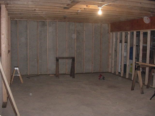

General Framing Pictures:
Equipment closet
We framed in front of the half wall (foundation) to build sliding panels to cover the windows. Here is the track we used.
Panels Open
Panels Closed
Screen wall with wiring installed.
See less See more

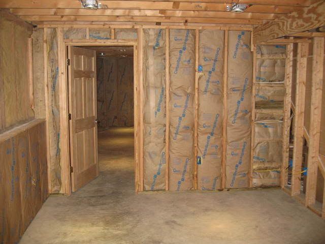

Entrance to theater:
Insulated Screen Wall
View from screen wall
Window wall with MDF sliders open
Window wall with MDF sliders closed

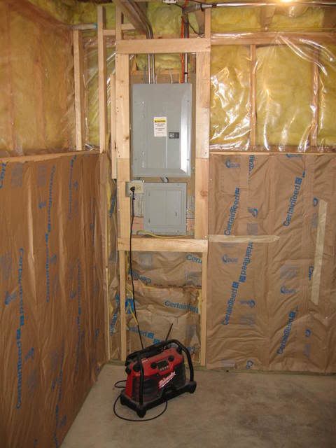

Main panel with sub panel added for theater and the rest of the basement (located in other area of the basement)

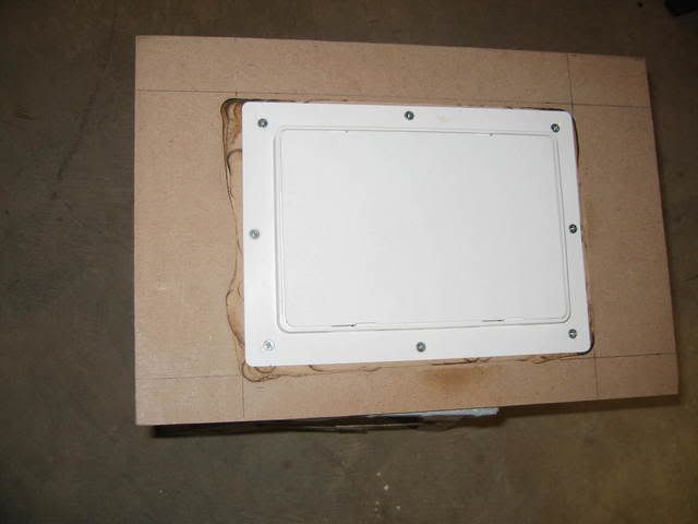

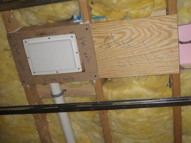

Projector box
Inside of projector box cover

Outside of projector box cover
Cover mounted

PVC run to projector box
Entrance of run in to equipment closet

Projector box, mount plate, and RC1 channel installed.
RC1 installed, waiting for drywall

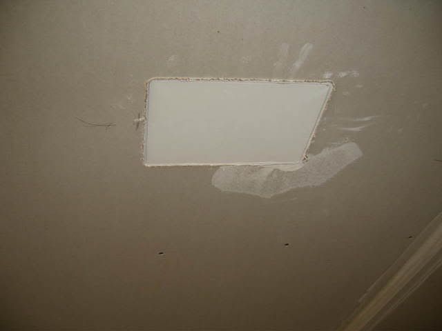

Entire basement is now drywalled with the first coat of mud and tape in place. Great work so far by the guys I am having do the job. They are using bullnose on all corners that I think makes for a nice clean look. Will post more shots once they are all done.
Flush mounted access panel for projector box.

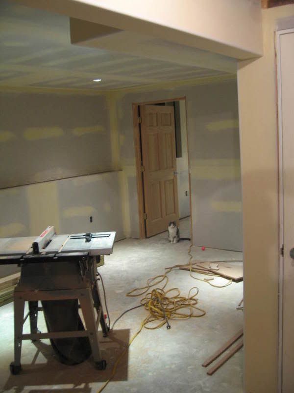

Drywall work is done! I am VERY happy with the quality of work and
attention to detail! The bull nose edging is a really nice touch.
Turning the corner looking at the theater entrance.
Screen Wall made out of 5/8" MDF caulked seams and filled screw holes.
Eqiupment closet
Closet detail of bull nose work and perfect seams

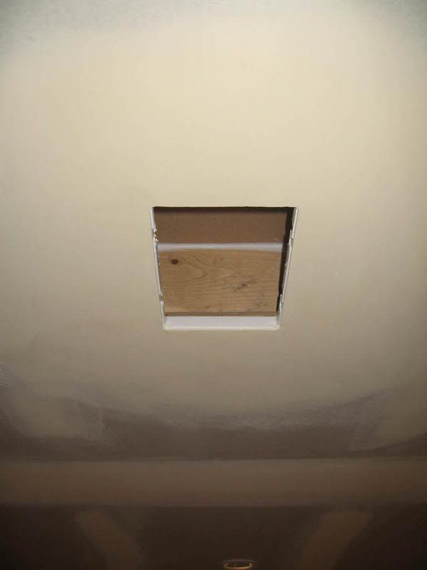

Finished projector box access panel.

Sorry for all the questions, but I'm very interested in your idea for the projector box. Where did you get the projector box cover? I'm looking to do the same thing. How does the cover come on/off of the box? Is your plan to mount the projector in front of that box? How will the wires look coming out of the ceiling?
Heh that is a simple plastic access panel that can be purchased at ANY Home Depot for less than $10. It clips into the base pretty tightly. The projector will be mounted in back of that panel. I will drill a hole for the wiring and probably use a grommet for whatever size cables I wind up using. I am planning on building a hush box for the projector, but in case that cannot happen I wanted a nice clean look.
