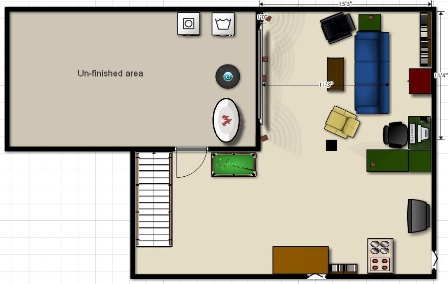

OK on with the plans, below is what I have now more or less, a variety of kid junk in the non-theater space.

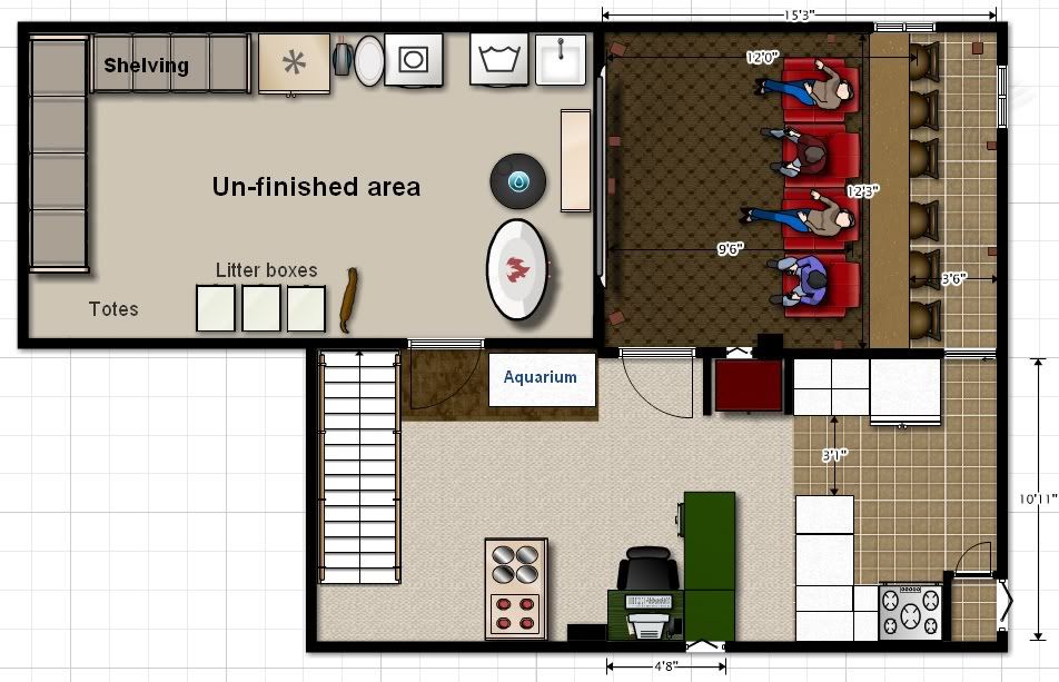

This plan shows the proposed changes. I will be splitting the space in two by adding a wall. The bar area will be accessed by a pocket door and the theater seats by a standard 3-6 interior door. A solid core door probably wouldn’t make much difference since there isn’t any soundproofing anywhere else.
A number of HVAC vents will need to be added although with only one vent and 5-6 people heat build-up hasn’t been an issue so far. Superbowl party with 8-10 will probably be a different story, so more HVAC.
The only tricky cabling should be the rear and right surround speakers. I plan on running speaker wire through the bar structure and then behind chair rail/wainscoting that will surround the perimeter of the bar area. The left and right surround will be mounted directly to the top rail of the wainscoting. The wainscoting will stop just past the theater seats since it will be painted white. This will keep me from ripping down a lot of finished drywall and drilling through studs.
There is a huge soffit that runs down the left of the theater that has the main support beam and HVAC ductwork (you can see it in the two pictures below). The L/C/R and front sub cables will route into the unfinished area and then down the soffit to the rack.
I’m pretty happy with the theater area floor plan, I think it gives me the most occupancy for the small size without having a second row backed up against the back wall.
The kitchenette and rest of the space I have redone a number of times and this was the best I could come up with. The small closet in the bottom right corner is where the breaker box is so I need access to that. The green desk is a must, if I’m not watching a movie I’m on my computer (with what little free time I have that is). You’ll notice that there isn’t a sink in the layout. I’d like one but I’m not about to yank the carpeting and jack hammer a drain in the foundation for one. I can walk my butt up to the main kitchen and clean a pan/dish if need be.
The main purpose of the kitchenette is to make popcorn, wings, nachos, place for beer and drinks so I don’t have to miss much of the game/movie. Also no powder room, just isn’t enough room for it.
So with all that is there any glaring issues, things I’m not thinking of? I’ll add some acoustic panels at first reflection points and perhaps on the back wall but that will probably be the extent of it.
The projector will be ceiling mounted, the joists run north to south so that is an easy run. The ceiling will be painted black anyway.

I may up my timetable a tad since I can do it in two stages. Nothing is going to happen until football season is over though (I’ve been waiting for football ever since it was completed). I do plan to move my desk out of the theater space so I can put some stools in the back for a superbowl party. So maybe beginning of February I can redo the theater part and just keep the couch until summer and then buy recliners.
I measured once while sitting on the couch and it’s about 10.5’ to my eye so this will be about a foot closer approx. For 2.4:1 the screen will definitely fill your vision (it’s 115” diag, 105” x 45”) for 1.78:1 its better. I may need to steal a few inches out of the bar and bar area if need be. The bar is 18” wide and doesn’t really need to be, 14” would be fine. I have a 9-10” over hang on my island in the main kitchen and we eat there every night and the depth is good. Maybe another couple inches from the bar space and that would put the distance at 10” which would be better.
Having two entrances is a bit odd, the only other option would be to go with three recliners and a much smaller free standing bar or one attached at only one side. With four in the family I don’t think I want to go that route. It also complicates running wire to the surround speakers. For football watching it will probably be at the bar for a good part of it and movie watching in the recliners. I don’t expect there will be much going back and forth from recliners to bar.

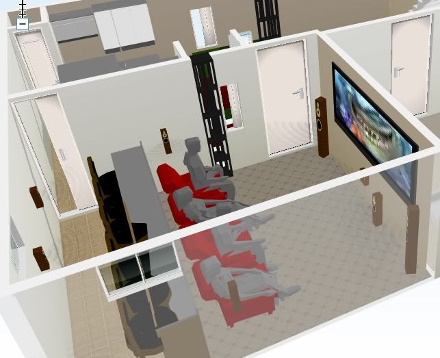

I need to learn sketchup, floorplanner is easy to use but just doesn't look that good.

I would agree with the previous post about it being a bit odd with no access to the bar from the theater floor. You may want to grab something quick from the bar and hop back into your theater seats. Have you considered removing one bar stool and making stair access instead?
It's not ideal but I just don't think there will be enough room. Even with somewhat smaller chairs (the ones I like are 120" for 4) it's only going to leave 9 or so inches of space on either side of the chairs before the support post. So six inches or less between the right and left chair and nearest surround speaker.
As of right now I have the speaker wire going through the bar so not having it connected would cause issues there as well. I'll have to think more on it and see if I can come with something.
Paying off bills and waiting for money to save up is getting me down. I've scaled back my plans a bit and just did a spreadsheet for material/labor and it's looks like at min. I'll need $8,500, probably close to $10k if past experience on building things is any guideline and that is without buying any new equipment (no recliners just using the same old furniture I have now). That's going to be a year from now, easy.
I don't want to do it piece by piece as I don't want the theater out of commission for a long time.

Here is a slightly revised plan which I think is more realistic.

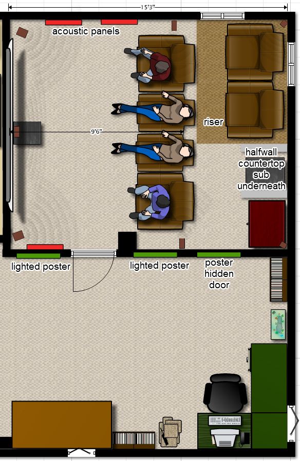

It might make everything easier by moving the 4 seats to the back and 2 to the front. Then you could wall in the back right so you only have 1 entrance in and have the walkway to the riser be from the far side so you don't smack your head on the soffit.
No matter how many floor plans I try the two entrance thing just isn’t working for me. I’m going to have to split the seats into two rows of 3 (luckily there are two armless and four, two-armed chairs).
I took a look at the soffit that was built 10-15 years ago and I’m just going to have to bite the bullet and move the HVAC lines to the opposite side of the main support beam. The supplies for the basement can go above the beam and I can add more vents as necessary. I need to make changes to the HVAC anyway since I have dead branches after my most recent family room addition (we cut off two vents).
Assuming I can have that done without huge expense it will cut a 5’ soffit down to a 1’ soffit (on the theater side) which is much more reasonable and will allow for a larger riser in the back row. There is a lot of cabling for satellite and I think at least on grounding cable that runs between the support beam and the main HVAC trunk so opening the entire soffit up will let me clean that up.
I think I’ll have to remove the rack from the room so I’ll need to account for an IR repeater/blaster (I think that’s what everyone uses that doesn’t have a rack in the room?). This would allow me to put the 15H in the back left corner and leave adequate space for the 2nd row. Entry would be from the back left of the theater.
This also allows for 3 illuminated posters outside the theater and a number of acoustic panel/posters inside. I’d also like to do a shallow soffit/light tray around the room but that would require some unusual design around the windows. I don’t mind plugging the windows but since these are the only means of egress in an emergency (fire on the main floor or something) they need to be accessible.
See less See more
Hopefully this will be the final floorplan. All speakers will be in enclosed columns except the sub.
