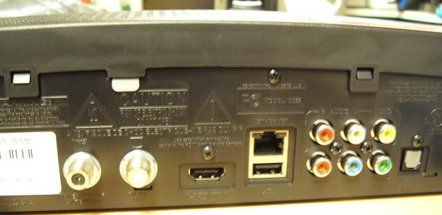

The DTVPal DVR has RF, composite (RCA), component, and HDMI video outputs; it has analog stereo and optical (TOSLINK) audio outputs. Output via component and HDMI is selectable 480p/720p/1080i through a menu. All outputs are active simultaneously and the box will downconvert HD channels to SD through composite and coax for older televisions. There is no Firewire output, and no way to directly download recordings from the DVR.
Despite initial reports to the contrary, external drive expansion is not supported. That said, you can replace the original drive with a 1TB version, increasing capacity from 30 HD hours to 142 HD hours. Software updates to address known issues will be made available for download over the Internet using the DTVPal's ethernet connection.

  3. How do I connect the DTVPal DVR to my TV and surround system?
    The DTVPal DVR supports both HD and non-HD displays. It outputs full high-definition through component and HDMI, and it downconverts HD channels through coax and composite for those with older TVs.
    If you have a HDTV or a 480p EDTV:
    • Connect the DTVPal DVR to your display with component or HDMI. HDMI carries both audio and video. If you use component for video, you'll also need to connect the analog stereo outputs (red and white RCAs) to your TV for sound.
    If you don't have a HDTV or 480p EDTV:
    • Use the composite or coax output from the DTVPal DVR. For the best picture and sound on older TVs, use composite video (yellow RCA) and the analog stereo outputs (red and white RCAs).
    If you have an A/V receiver or surround system:
    • Connect the digital audio output (optical or HDMI) from the DTVPal DVR directly to your receiver or surround system. In most cases, you will only get 5.1 surround sound from the DTVPal DVR if it is connected directly to your surround system.
    Note the DTVPal DVR does not have s-video, and its component output can only be used on TVs that support 480p, 720p, or 1080i.

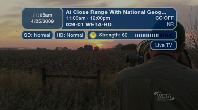

  4. How can I tell whether I am getting program information from TVGuide?
    TV Guide On Screen (TVGOS) program information is distributed by CBS affiliates in these markets . When you receive program information from TVGOS, TVGuide logo is displayed in the upper-right corner of the guide, with 8-days of program information for most major networks. Channels without TVGOS information display the more limited program information available via PSIP.
    Note the TVGuide logo in the upper right-hand corner.
    If you do not see a TVGuide logo, then you are only receiving the more limited information provided by each individual broadcaster using PSIP. Typically, only 24-48 hours of program information is available through PSIP.

    Instructions to remove the cover, courtesy of AVS member otaviewer in this post :
    - I unplugged the power
    - Removed the smart card from the front so I didn't accidentally break it
    - Removed the visible screw on the case's bottom
    - Pried off the rubber pad on the case's bottom which is closest to the green and yellow RCA jack and unscrewed the screw underneath
    - Pried off the rubber pad on the case's bottom which is diagonal from the one just pried off and unscrewed the screw underneath
    - Looked in the slots on the bottom of the case with a flashlight to see that an object could be stuck in them and bent slightly to unlatch, except for the three inner slots with green circuit board visible which can be ignored
    - I unbent four medium-thickness 1.5" (2" long measured with a ruler) cotter pins, the kind obtainable from a hardware store, to a 90 degree angle
    - Inserted one end of the cotter pin straightly into either one of the two slots closest to the back of the case, to the point where it stopped on its own
    - Carefully applied sideways pressure (relative to the case) to the cotter pin so the part of the cotter pin outside the case moved away from the case and the part of the cotter pin inside the case moved toward the other rear slot
    - At a certain point while bending the cotter pin sideways and applying slight downward pressure, the cotter pin slipped farther into the case. I let it slide in a bit more. This unhooked the latch in the slot and allowed me to remove my hand from the inserted cotter pin during the rest of the steps.
    - I repeated this with the other three slots using the other three bent cotter pins. Noted that the slots in the front only allowed me to insert the cotter pin slightly past the point where the cotter pin stopped on its own.
    - I Inserted a flathead screwdriver in between the top and the bottom of the case at the closest corner to one of the back cotter pins
    - Twisted the screwdriver at the corner to pry the top and the bottom of the case apart slightly but not enough to damage the case
    - At the same time, with my other hand, used another flathead screwdriver to unhook the closest of the two tabs on the rear of the case. That corner of the case now opened up farther
    - Removed the screwdriver from the corner of the case
    - Inserted the screwdriver slightly to the outside of the tab that the other screwdriver is in, and used it to pry apart the top and bottom of the case just to the point where the screwdriver fits in between the top and bottom of the case
    - Removed both screwdrivers, and noted that the top and bottom of the case remain somewhat separated
    - Repeated the last six steps with the other rear corner
    - I separated the top from the bottom of the case at the back of the case with my hands, without much effort, and noted that this caused the front of the case to also separate

Credit for this image to rustycruiser. More unboxing photos can be found in this post.
