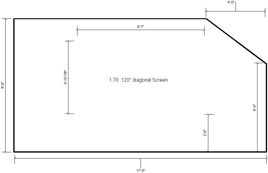

Ok I have a few questions to start. Please take a look at the drawings and tell me what you think I should do about speaker placement. Screen size…according to my drawings do you think my calculations are right? This includes projector placement, seating distance etc. I have a ton of questions but I don’t want to ruin my welcome!

I would rather go with a 2.35 screen but I am afraid of going wider because of the angle on the ceiling. I would have to lower the screen and screw the viewing angle. Any thoughts on this anybody?
I have been struggling with the idea of creating the same angle on the opposite side ceiling to make it more asthetically appealing but I don't want to crush the area in the rear of the theater...especially after the riser will shorten the ceiling height. Any thoughts there?

A couple renders for you to take a look at. I wanted to get a feel for what the screen wall will look like so I put this together for visualization. This is a 128" 2.35 screen. In my initial post I have a 120" 16:9 screen..I would rather go with the 2.35. What do you think about the size...should I go larger or stick with that? The angle is a killer as you can see. Thnaks for any feed back on my questions. I am about 99% on framing and need to get a handle on the screen wall. Do I go with speakers behind the screen or build out the sides? Also speaker placement on the surrounds. On the angle side I am at 6'. Just need some feedback guys...a bone or two.

Wow, your screen is BIG! Ok that is convincing enough for me. The only thing I am worried about is light reflection on the angle wall. I could go lower but then I am worried about viewing angle...especially from the rear. any thoughts there?

I have a 13" riser and my screen sits 24" off the floor and from my rear seats I have about 4" clearance viewing from the top of my front row seats. but when everyone in the front row is reclined its more. When I'm watching 16:9 material my screen is about a 120" diagonal. With the space you have I think you could do a 10' wide screen easy and put the speakers behind the screen. You could always put fabric on the ceiling out about 4 feet
Don't know if you have scanned through the 2.35 picture thread or not
http://www.avsforum.com/avs-vb/showthread.php?t=561280

Thanks Scott. I just finished reading your build thread...you did some very fine work. Those surrounds are sweet all snuggled up in the columns. Not sure how I am going to deal with that part yet. I am pretty convinced to go 2.35 and I agree on 10 feet. I think it will be more like 10' 8". The speaker behing the screen is also what i want to do...it just looks cleaner.
