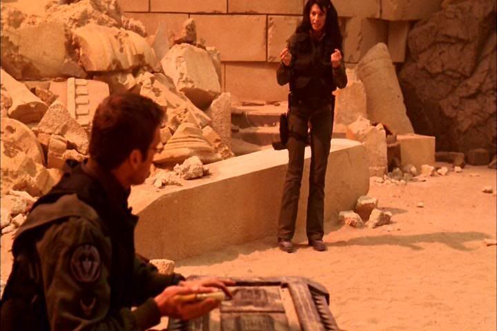

I think impatience might be overpowering prudence at this point, as I am increasingly getting the urge to just take the plunge and hope all works out for the best.
Here is an example of what I am trying to avoid. Here is a screencap from a not-that-well-composed shot in Stargate: The Ark of Truth, capped from the DVD:
And here is what I saw on my 34" Sony when first watching the movie upon having purchased it (approximated):
Furthermore, this article makes a very good case for why we shouldn't put up with this...
