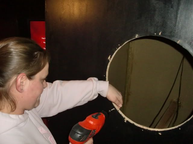

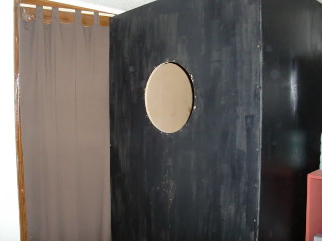

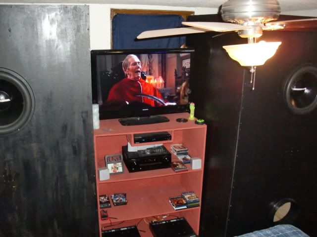

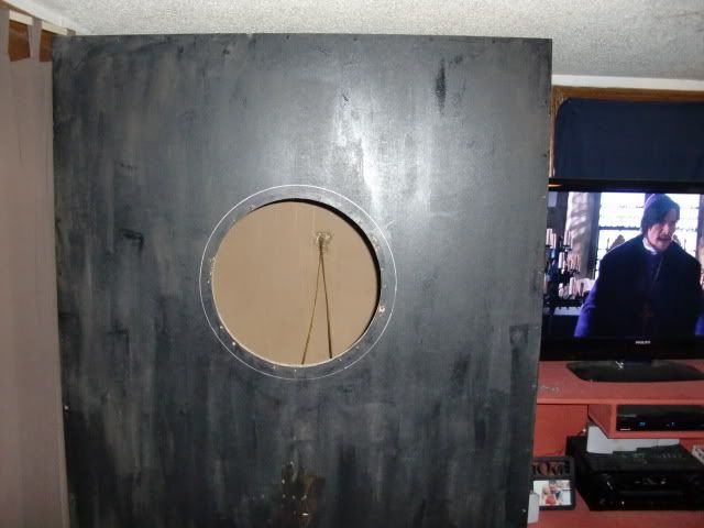

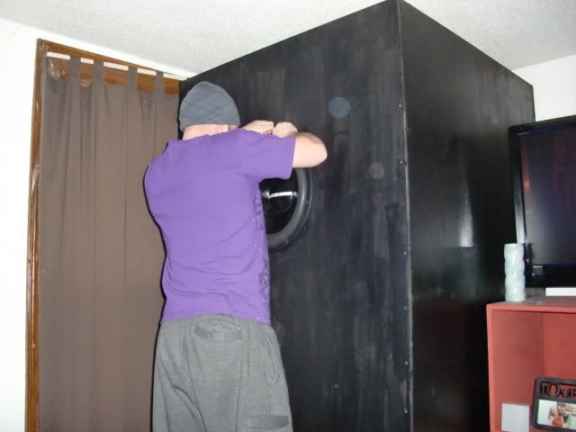

I wanted my opening line to be " I just ordered two Incriminator Audio modded Death Penalty 21's" or " I just ordered two Maelstrom-X 21's" but I haven't heard back yet, so I am jumpin the gun a little, but here goes the beginning of the mod. The initial goal was to get two of the largest drivers with the most Vd, Fi Audio IB3 22's that are supposed to have 96% of the Vd of two IB3 18's, put them in the largest enclosures possible keeping it simple with 4'x8' sheets of MDF without joining pieces together. So the towers are 4'x4'x8' with a 12" port 5" long for about a 13Hz tune. I was running a pair of 18's temporarily at 8 ohms (custom dual 4 ohm coils) until th 22's came out then get dual 2ohm coils and run the 22's at 4 ohms. I want the lowest Q I can get with the largest single driver to get as much of a natural peak from 20Hz on down.

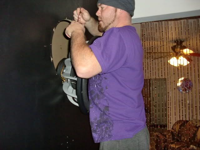

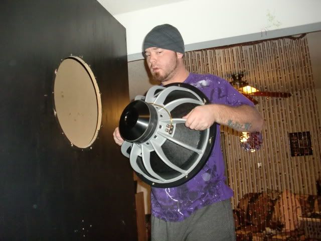

out with the old, those will get reconed for the VAN

I was very pleased with the 18's should only get a touch better with 21's

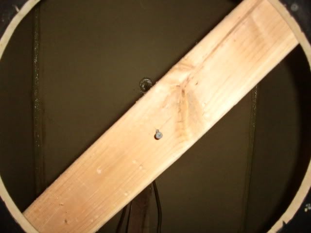

Only problem besides electrical to back up current draw was the woofers causing the baffle to flex around the drivers but I'll be fixing that.

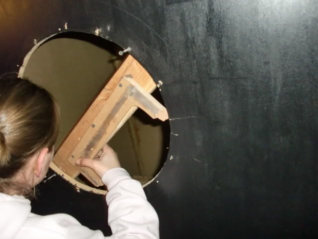

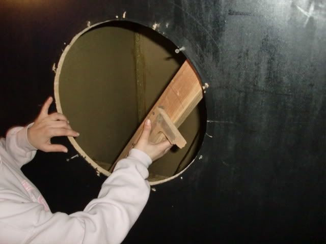

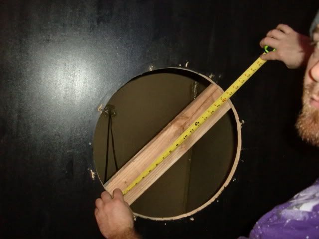

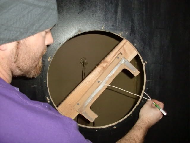

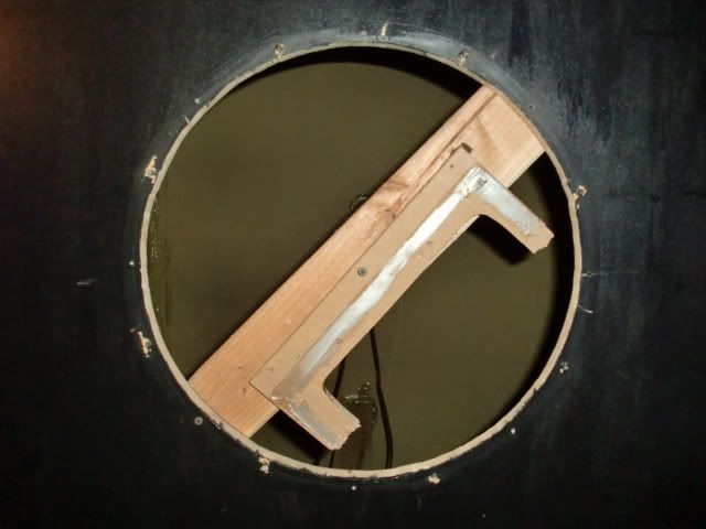

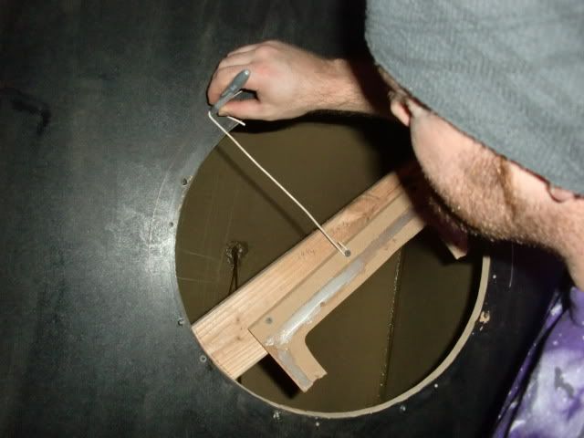

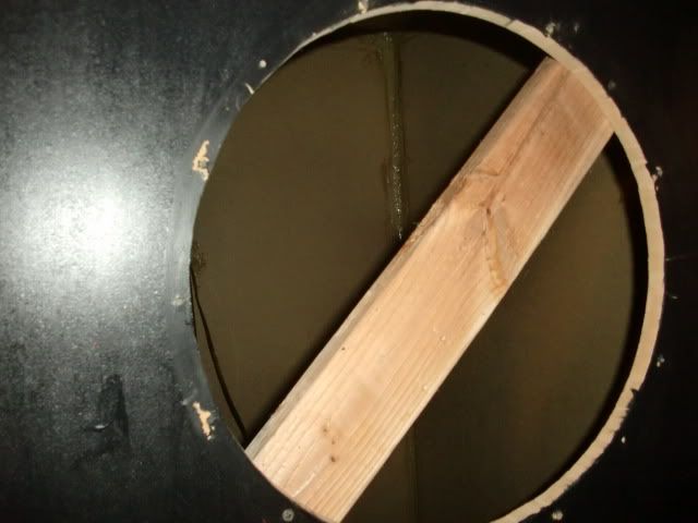

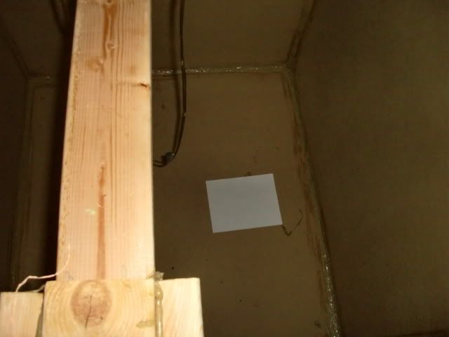

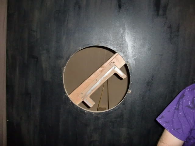

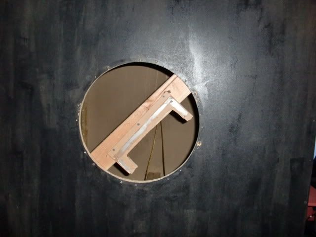

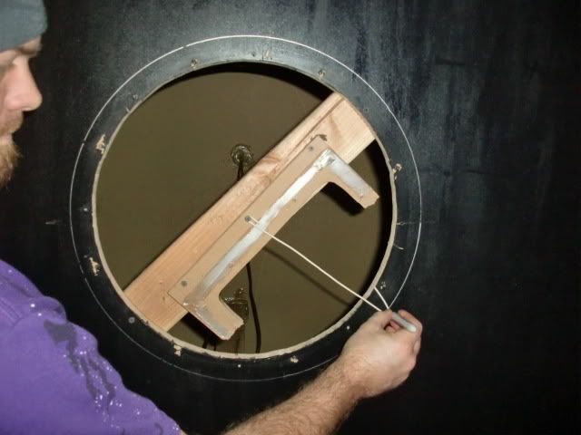

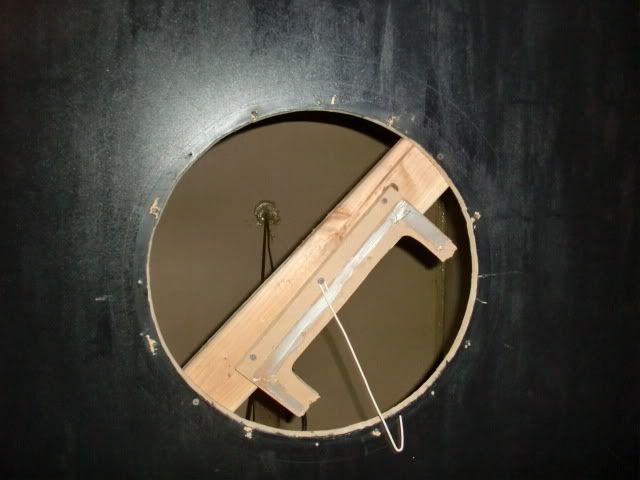

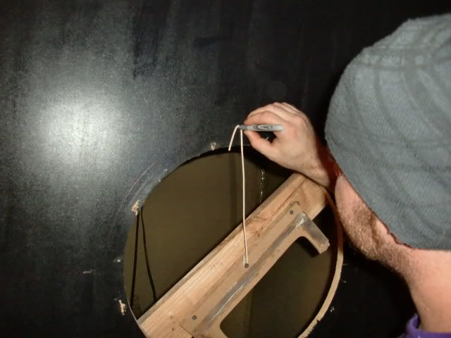

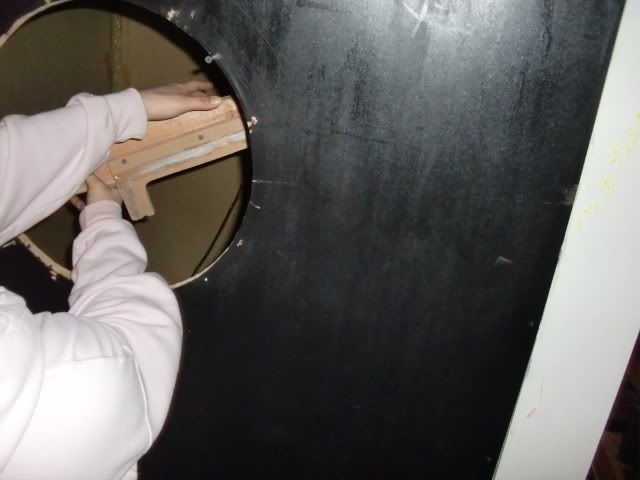

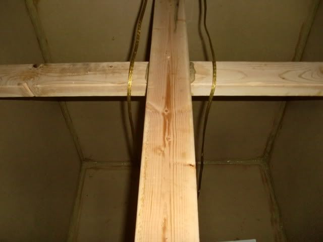

I will reitterate: I think people go overboard on bracing sometimes, I feel people get too concerned with port resonances, panel resonances, decay, little peaks and dips, imaging, yadda...I'm no SQ guy, I am a sloppy lazy guy. I have seen so many boxes with panels less than 2'x2'x2' with a **** ton of bracing. Good for them, props to them, I won't hate. I will not argue that it is not effective. It looks badass, it makes things solid, ridgid. It makes your enclosure perform closer to the predictions by minimizig losses. I am all for it. But it is NOT me. Furthermore, I have 4'x8' panels with only a single center brace and I:
Barely suffer from pressure flexing! The only flexing issue that I have is the driver force itself flexing the baffle. It is only a serious problem by the drivers. The bottom 1/2 of the baffle seems to suffer a touch from the ports, but the side panels do not have the problem.
Because of this, I am putting braces in the 4 corners of the subs, this should also help support the large drivers weight that is centered so far back. Then 2 more braces on the upper corners of the ports. Front to back.
