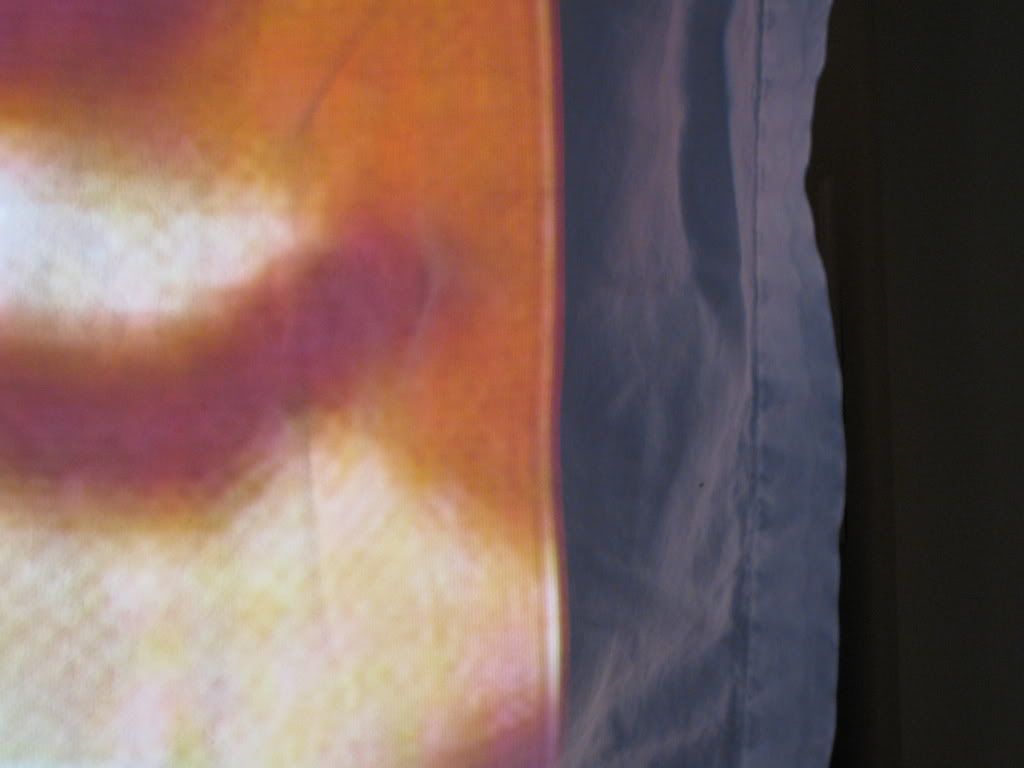

There is a line down the right side of the image, being fed from a S350 via HDMI set to 1080p to my 6500UB
this is a SD DVD you can see the line faintly
I turn off the the dvd player and it is gone:

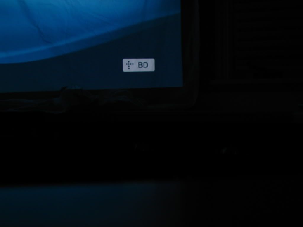

on the default splash screen it is not there either

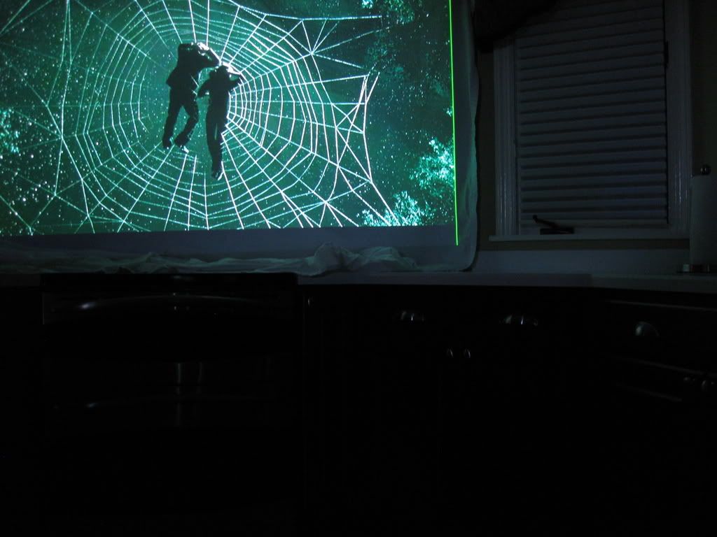

Then I play the BD demo disc that came with my PS3 and BAM!
Now, I will note one thing. When I first start the demo disc and go to videos and play the first chapter, welcome to BD or explore BD, I dont recall the exact wording but it is the very first choice under the demo videos, the green line is not there. As soon as you go to chapter 2 the line shows up. I rule out the disc because it was there on my standard DVD too.
- I tried 2 different 6 foot HDMI cables and both HDMI inputs.
- I connected it via component at 1080 i and I did not see the line
- I found some things talking about this being because of upscaling, so I tried hard setting the player to 1080i as well as auto, but both times the green line is still there via HDMI.
- There was another suggestion I found that said to bring the image in 2 pixels or something like that, but that just doesnt sound right.
Has anyone else seen or heard of this with their 6500UB. I have a feeling it is not the projector though. I may try some normal HD content via Dish but that will require some configuring on the kitchen counter...

Does the 6500 show you the actual input frequency?
eg 1080p60 or 1080p24? I know that on the PS3, a lot of the FBI warnings are in 1080i60 but the PS3 will switch to 1080p24 when the movie proper starts.
The reason I ask is that it could be that the green line is only when you use 1080p24, but not at 1080p60, for instance.
Most of the time, the projector should do an "auto" adjust of the image that is being projected, but if it is not doing it right, there should be an "image" position adjustment that allows you to shift (in your case) the image slightly to the left and you can shift the green line out of the displayed image.

The problem is the source signal, I had the exact same problem on my system. I have an HDMI cable from the cable box to my projector and component connections from my DVD through the AV receiver.
On my Epson 1080ub pro, I went into the menu for Image and under Output Scaling, I adjusted the setting from 100% to 98% and the green vertical bar disappeared. Hope this helps you as well.

Well, it appears the issue is with the output scaling on the projector. For some reason when some of the content is playing I guess it scales fine but others do not.
My real question is, what is output scaling? Is it bad to set it to 98%? 100% has the line, auto still displays the line, however, 98% is good. Now to figure out what this actually means. As a noob with projectors and higher end equipment I still have a bit to learn, so any input is helpful. Thanks

Well, so far, I can conclude that the vetical line is not present when I connect the Sony S350 to my 720p 50" Panny, so the next test will be the PS3 on the projector as well as a HD TV signal. So I dont know right now, it could be the projector...?

I learned in the manual that because I am using HDMI input that I cannot shift the image position as suggested. I tested for an hour last night with my S350 and PS3 but nothing made the vertical line go away. At one point it was actually blue while watching the SD version of behind enemy lines. With the stuck pixel I have I am hoping for replacement, and with that, I am hoping my issue is in fact the projector and that when my new projector arrives, it comes with no vertical green line.
