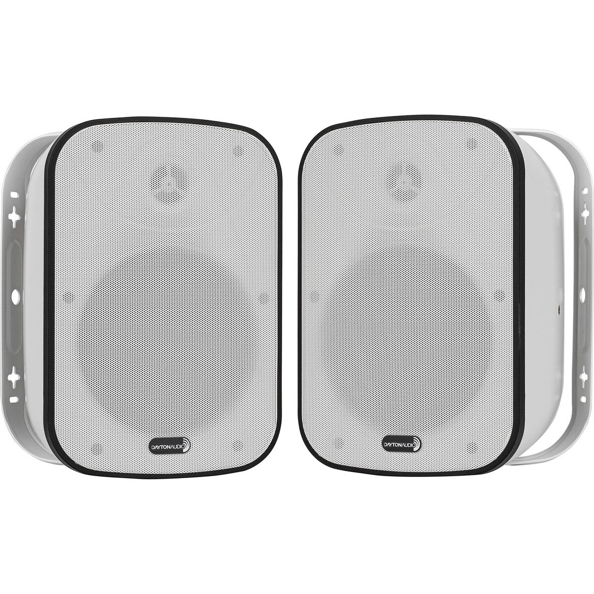

I have these under my patio and previously had a set of KLH outdoor speakers. The Dayton's are quite decent with an open and airy sound and decent bass with the passive radiator. I have mine positioned horizontally with the tweeters outboard and was pleasantly surprised to find a center image about 15 feet away in a lawn chair. There is also an 8" version with more bass but considerably larger.
