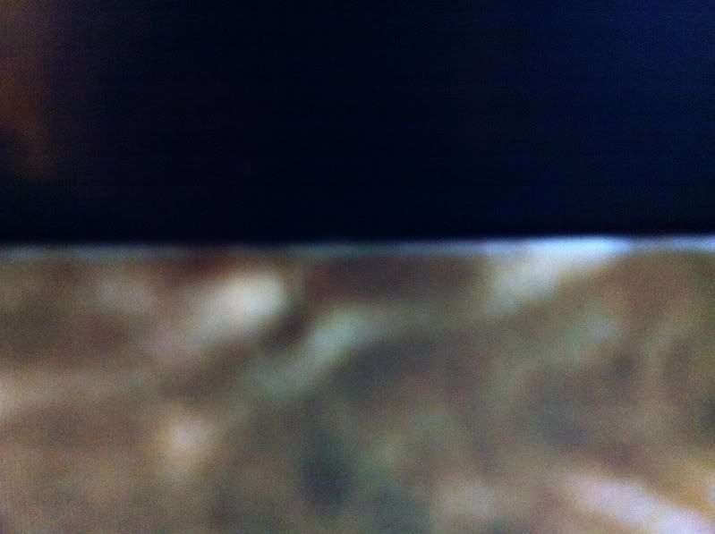

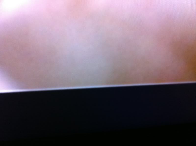

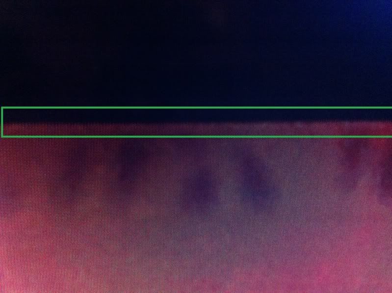

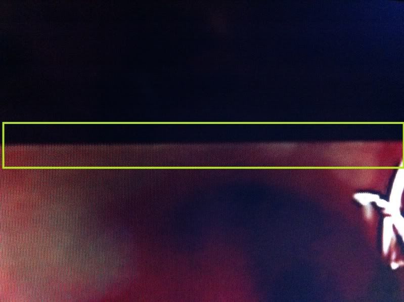

So i just got a new LG LCD TV, but I've seen it with my parent's plasma Samsung as well and on other TVs.
Anywhere near a black bar/border there is a thin band of a lighter color (it's part of the video but looks like there's a clear thing filter over a small band of picture)
It's very distracting
Here are some pics to show my example

Looks like light leakage from the CCFL which is at the top and bottom of the TV. Suggest u change it if it bothers you so much unless you can reassemble the BLU (Backlight Unit)

It is actually on the edge of the blackbar in movies that are 2.35:1 etc. So it's a good 4 inches in from the top/bottom.
