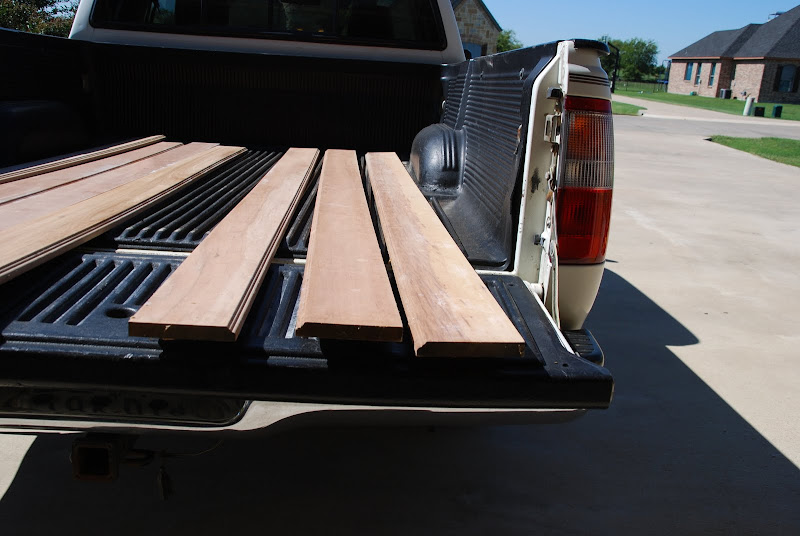

Fronts, backs and sides for two boxes. Oh, and two pretty faces (on top of the stacks--those are the two glued panels). Each box will have two forward-firing 10" NHT 083s in it. Those are for the rear of the room. For the front I intend to build two boxes, twice as tall with four forward-firing 083s. 8 up front and 4 in back still gives me 12 Thunder-Makers in the living room. If that's not enough to annoy my neighbors, I've still got 6 more of those drivers waiting for boxes. Sweeeet!
The 3/4" Aruco plywood does not have the look I want, so it is likely that I will do some veneering.
In the truck bed, the Two-By-To-Be stock is baking in the sun.
