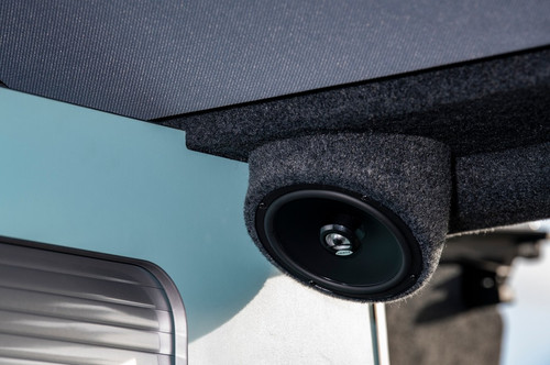

And now to what I think might be the ideal Atmos height speaker : Kicker KB6 $75ea
I have 8" Wharfedale PA speakers all round in my 7.1.4 setup, but I wanted to add front wides and 2 more heights, but the Wharfedales are too expensive new ($300AUD each) and none have come up recently secondhand. So I started looking for something comparable with a compression driver tweeter and the only things I could find was Behringer PK108 PA speakers or no-name brand PAs, but even they are expensive here.
Then I came across Kicker KB6 / KB6000 outdoor / marine speakers with CD tweeters and 6.5" woofers. They retail here for $150AUD ($150USD a pair in the States) but I scored 4 from a pawn broker for $150.
Just finished testing them and they sound great, and as expected with a CD they have no trouble playing loud.
Being an outdoor speaker they are compact(ish) and come with a bracket for easy fixing to the ceiling and easy aiming to perfect spot.
I am a big fan of having all identical speakers but after replacing my 4 4" bookshelf height speakers with the 8" Wharfedale PAs, I didn't notice as much of an improvement as I expected so I am prepared to run non-identical heights, and these mean I can afford to get another 2 to make it 6 :)
