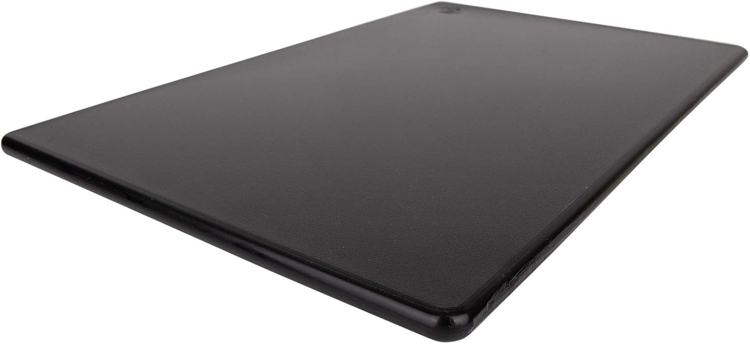

Hi y'all, I was wondering if it's safe to use a precut 0.5" thick HDPE cutting board to significantly widen the top mounting plate for a center channel to sit onto safely. I plan to countersink two holes so that it can secure onto the stand. I looked at MDF but then I would have to paint/seal it to prevent moisture ingress. Any thoughts or suggestions would be greatly appreciated.
If this is a go, I'm also hoping 3M adhesive tape would stick onto it as I can use black rubber bumpers to keep the speaker secure.

I can't see any reason why you couldn't? If at all possible, I'd suggest that, as well as screwing, that you glue the board to the other surface, for extra long-term strength. Just ensure that you keep it away from any heat sources, as it may bend if it gets too warm. If the 3M tape doesn't work, you could attach the rubber bumpers with screws from underneath. I'm sure others will be able to give you some advice as well. Good luck.

The Focal stand came in yesterday but unfortunately the triangulated steel top plate holes don't line up with the three on the center speaker.
For the engineers out there, which fastening method should be stronger/more secure in 1/2" HPDE plastic:
1) countersunk with a countersunk screw (best appearance since it's flush with surface)
2) regular hole with a panhead screw plus a washer:
#13 ·
Not an engineer but we used HDPE as sliders for “sticky” areas of our frames when off-roading (excellent use for HDPE :)). Really did a good job reducing hang ups just due to friction between a rock and piece of metal. We always used a washer with a pan head bolt.
That being said, your center isn’t a 5,000 lb SUV so I suspect either will be plenty. If you go the counter sunk route, just don’t over tighten.

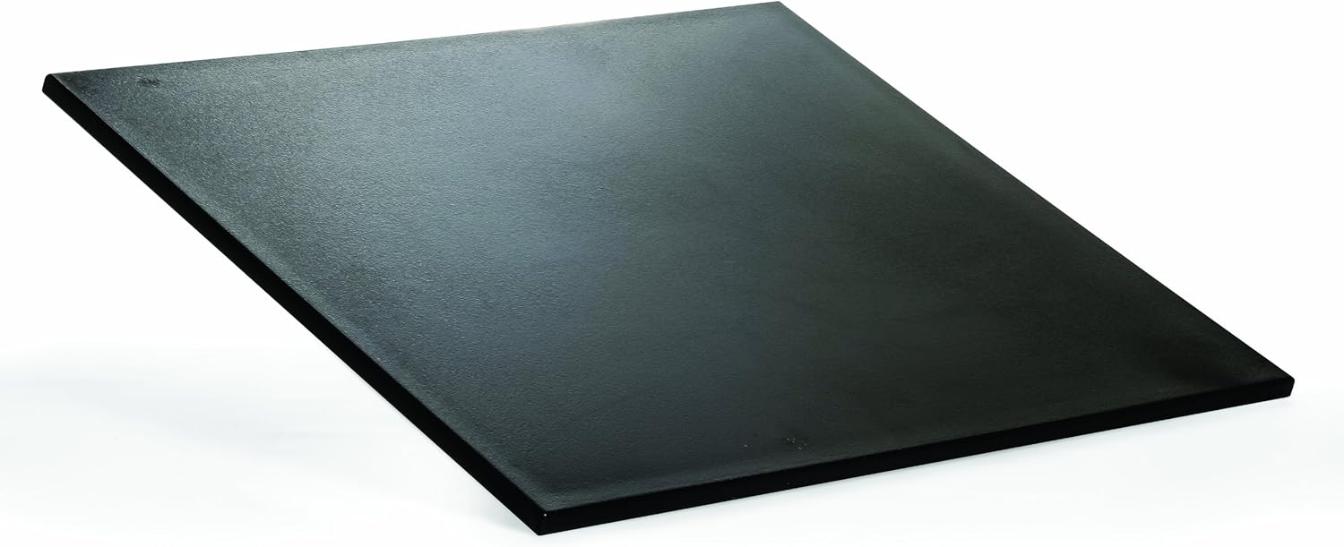

#15 · (Edited)
Thanks for the suggestions guys. I already purchased the HDPE sheet in a good size and thickness so I just need to make a template and drill holes to form a triangle. I just came across this after some Googling as well... but then again this was from a molded plastics website. Seems like a lot of people countersink with nary a problem. Either I'm overthinking this or paranoid I'll end up having a dropped 41 lb. center channel on the ground 😅
#21 · (Edited)
Updating this thread with some photos. Got me a nice set of KEO single flute (USA Made) 90 degree countersink bit set. Worked like a hot knife through butter with a Li-ion hand drill. A drill press would have made for straighter holes and countersinks but this isn't a critical job at hand =) The 1/2" HDPP cutting board worked out perfectly with a nice blend of strength to weight. The board I bought off Amazon also had rounded and finished edges for a professional appearance.
